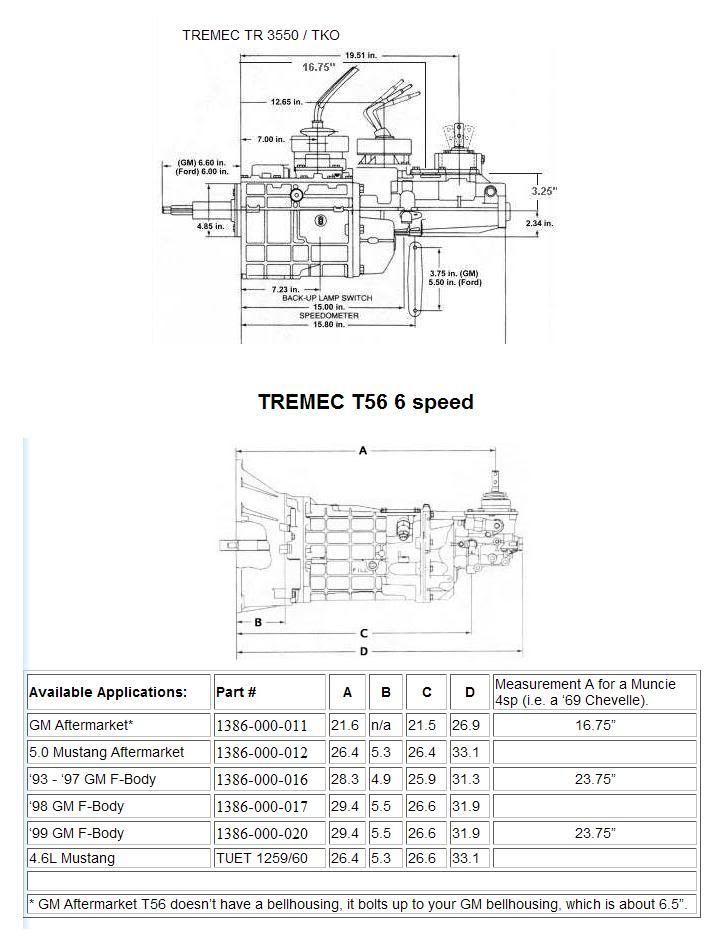

What would it take to put a
631 Views 16 Replies 10 Participants Last post by  greenbullitt
6spd manual from an ls1 fbody behind a 302?

They use the Viper T56 behind the fords. Standard Gear in FTW used to sell a "kit" with everything. And if you are thinking about putting it under your 69, get ready to cut.

Is a 6spd larger than a t3550? I would rather not have to do *much* cutting, but the t3550 will slide right in.

Here's a writeup of my TR-3550 swap into the chevelle on JAM Performance Transmissions' site: http://www.5speedtransmissions.com/71tunnel.html

Well, did some google'n and found this [URL="http://forums.vintage-mustang.com/showtopic.php?tid/1500607/tp/3/"]http://forums.vintage-mustang.com/showtopic.php?tid/1500607/tp/3/[/URL]
So now my biggest problem will be getting a bell housing to go from a gm fbody T56 to a 302.

Thanks for that link.Looks like I would need 8750-06 to make that swap.
Guess I will start google'n what clutch to use.
no problem.. Any 26 spline input 10.5" clutch kit should work. I have been doing research to try to put a t56 behind my fox.
