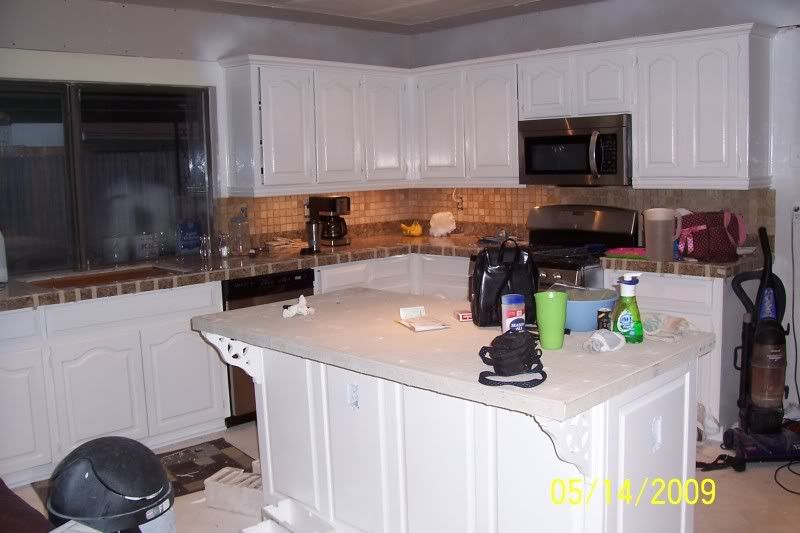

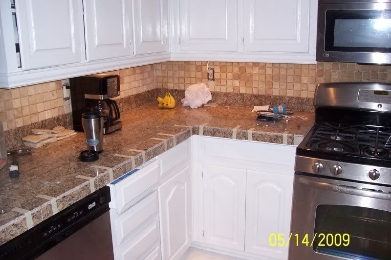

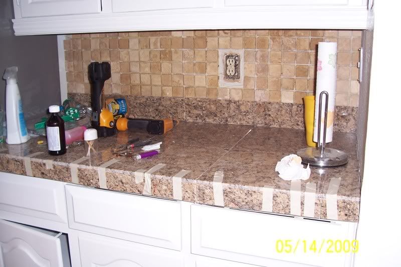

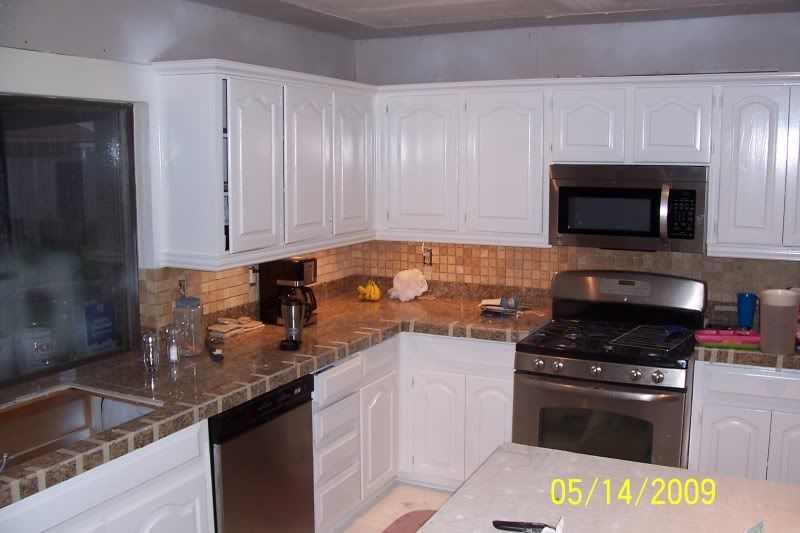

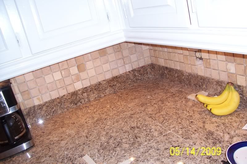

i found my granite and travertine on craigs list at a place that was closing out, paid $3.00 per tile and $3.00 per 12x12 1"travertine. i sprayed my cabintes i didnt want brush strokes, and i put small finish nails at the lower corner of each doo to keep them open enough to not touch. after they were dry i got the little felt pads to keep them off the paint.
i did not lay my tile over the existing counters, i put down backer board. none of my cabinets or droors stick at all. i screwed the backer right over the counters

Everything looks good man. Did you have to do some heavy sanding on the cabinets before applying the oil base killz or did you paint right on top without sanding? My cabinets look exactly like yours and we're not sure how we want to update them yet... We also want to paint the wainscotted wood paneling in the living room too, but unsure of the best method to do that...

So you laid the backer board over the formica? What about the sink, just pulled it out, laid everything down and remounted it?

We are in the middle of painting our cabinets as well. We're trying to decide whether we should do oil based/latex based paints. The reasons I'm worried about oil based is the yellowing over time and the odor. I've talked to a couple of paint places (Home Depot then Sherwin Williams) and both told me if I get a GOOD latex based paint, it will work just as good as oil based, but without the negatives I posted above.
Our main issue is that we don't want them to 'stick' when opening/closing the doors. So since you have just done this, I would love your opinion on it. Also, did you spray yours or use a brush?
I'd also love any information you could share about laying the travertine on the countertops-we want to redo the counter/backsplash and it would be so much easier if we could just put it on top of the existing formica junk.
Thanks and it looks AWESOME!!! Huge difference!
What is on the cabinets now ? If they are stained, you will need to sand them with 220, degloss them, and then prime before putting latex or oil. If they are already painted with oil, you can put oil right over them after sanding and deglossing but if you choose to convert to latex you will have to prime them first.
The oil will gradually yellow over time. If you choose oil, I would use the Satin Impervo made by Benjamin Moore. If you choose latex, I would go with the Sherwin Williams Pro Classic brand. Both of those paints work well both brushed or sprayed.

You can lay it straight over the formica. I used 1/4 inch hardibacker screwed on 8 inch centers when I did my kitchen.

then i put crown molding above the cabinets and a lower trim and side trim and painted the cabintes with an oil base killz and then oil base white paint and removed all the old aluminum brick looking backsplash
then went the hardy backer and started installing 12x12 granite and travertine backsplash
this afternoon im gonna put in my black cast iron sink new faucet and do the island, and im gonna do a travertine inlay in the center. then i get to do the flooring and the bathroom, should all be done in the next few weeks, more pics to come

im not an expert on the cabinet thing, but i scuffed the cabintets then degreased them, with lacker ( sp) thinner, and i caulked the inlayed centers and used wood filler on any cracks or knicks. also my cabinets had a decrotive lower beveled edge, so i added a section of trim at the bottom.
i also added crown molding to the top edge to dive it a bit of a custom look. i still have to trim out the sides of the stove, dishwasher and the microwave to make it look right.
as for my sink, yes i pulled the sink and cut my backer board to fit the hole and then cut the tile. i went with a heavy ass koehler black cast iron sink to match the top of my stove, it was a bit pricey but worth it!
i started to lay tile last night ill get some pics this weekend, of it and my sink, i love that damn thing, my other sink was only 6" deep and the new one is 8" deep so leah if you get a new sink GET THE DEEPER ONE!

spraying the cabinets are definitley the way to go vs. the brush. Those cabinets look super in white. Whats that going on in the ceiling? is that 4" recessed? SS trim?

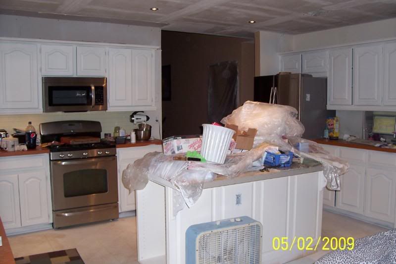

the section above the cabinets is new sheetrock where i took the soffet down above them, i scraped the cieling, and i still have to tape and bed and patch a couple holes where the old fixtures were. and then paint it and the walls
