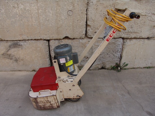

Its a little over 1000 sq ft on the ground floor and I got the walls painted this weekend. Ready to tackle the floor now. I guess the guy that had the house built had no intention of ever doing anything withthe floor. He let the sheetrock and texture guys spill crap everywhere. Some of it was 1/2" thick. Theres also something that looks like some sort of clear resin that I need to get up as well.
All the floors I have done in the past have not been this big or had this much surface crap to remove. I remember reading someone on here that did theirs and prepped by renting an expensive steel shot tool. Rental Stop has an Edco floor grinder. Anyone used one of these before? Is this overkill or should I be looking for a floor sander? the grinder sounds pretty good to me and has diamond blades.

I don't think that would be bad but, just don't let it "dig down". I probably would only do the tough spots with that machine and then sand the rest of it, or it might come out uneven..
just fyi-- I have never used that machine, but I am sure you have the same thoughts as I do with it.
Good Luck!
In my experience with staining floors, that's too aggressive to start out with. And trying to get 1000 sq feet to look uniform with a machine that uses 2 9" discs is going to be tough. I'd first rent their floor buffer with about 3-4 black pads, add water and the texture and paint scrubs right up. If yours is really 1/2" thick, I'd prolly chisel most of it up by hand otherwise, just keep the buffer pad on it longer and it'll eventually come up, just keep the hose going at a low spray, turn on some music and take your time. If you don't like the results of the buffer, then get more aggressive if you like.
BTW, my floor had some hard paint and texture on it as well and this is what I found to work best. Turns out the builder also painted some shelves in the middle of our floor and the buffer got it up with a little patience.

A pressure washer will do miracles with bedding material and paint...and it will move a helluva lot quicker than that montrosity of a machine.

It does look pretty menacing doesnt it? Wonder how fast those discs spin?
Fast enough to fling your old ass all over that 1000sq ft garage, especially when it "grabs" the concrete...LOL!

you have the correct machine..........but i have the diamond inserts you need to cut up mastic and any other kind of crap that might be on the floor. If they will lease you the diamond inserts go for it, cause it takes about $2K to fill that single machine with diamond inserts. a shot blaster will not take up mastic.

I have a 2500 PSI pressure washer but for removing minor suface paint and texture, and generally roughing up the surface maybe a 17" rotary disc style floor sander would be more suited for the task?
The grinder looks enticing, but how do you control the level of it? Sure looks like it would be one loud MF as well. How fast do those discs spin?

it's a very low rpm machine and the noise with diamaserts is really not to bad, and it controls it's own level, the wheels have enough surface area and float so as to not dig in, and trust me, it doesn't cut near as fast as i'd like it too sometimes.
If you don't have much of the tuff stuff to get up you can get one of those diamond wheels that's 7" diameter on a buffer and do it by hand..........this is what we edge with, but damn, it makes a mess and where a mask.

Lucky for me I dont have any mastik or carpet glue to deal with, only the paint smears and some wall texture near the base. I have scraped most all of it already. There is some unkown crap that looks like some sort of resin that was spilled. It's covers 20-30 sq ft. Hopefully the floor sander will make quick work of it.
My idea is to sand and remove surface contaminants, sweep, spot clean and pressure wash, rinse, then mild acid etch, and final rinse.

Cool, thanks. All worked out pretty well on the floor prep and went as expected except for the weird resin-looking stuff. I was highly disappointed that the sanding discs didnt hold up to it so I guess I am going to need to diamond grind it.
This almost looks like a rough finish that they ran a polisher over briefly. It has raised surfaces but is very smooth to the touch. It is also hard as rock.
